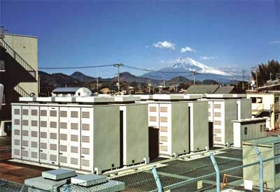

Xcel bought the battery technology (Figure 7) from Japan’s NGK Insulators. The batteries already are used in Japan to store wind energy. They are used in the U.S. for nonwind applications.
7. Power vault. The NAS battery installation at Tokyo Electric Power Co.'s Ohito Substation is rated at 6 MW/48 MWh. Courtesy: NGK Insulators
The system consists of 20 50-kW modules the size of two semitrailer trucks stacked on top each other weighing about 80 tons. The sodium-sulfur (NaS) battery stores a full charge of 7.2 MWh of electricity.
