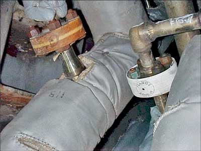

The down side of this approach is that the tape must then be removed — after it has been baked in place during testing (Figure 4). Removing the tape is an expensive, time-consuming, and thankless process, because a technician will inevitably spend hours scraping the tape from each flange when leak testing is complete. It you don’t scrape it right away, the problem will only intensify during the next round of leak tests, because the baked-on tape remnants make forming an air-tight seal impossible. And it’s always possible that tape remains make their way into the fuel system piping during the next fuel system piping disassembly.
4. Baked to a crisp. Tape used to seal fuel system flanges during leak testing is very difficult and time-consuming to remove. Courtesy: Flange Band-It LLC

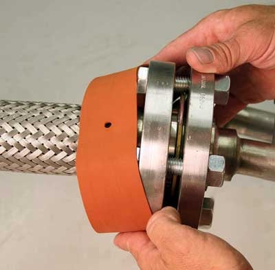

Joplin-based Flange-It LLC recently introduced Flange Band-It, a new product that makes scraping tape just a bad memory. When you read how simple this solution is, you’ll wonder why you didn’t think of it yourself. In essence, a flexible elastomeric polymer that can withstand temperatures up to 500F — a large rubber band so to speak — takes the place of the tape on virtually any standard-size flange (Figure 5).
5. Rubber band man. Instead of taping flanges. Flange Band-It uses a high-temperature elastomer "rubber band" to seal fuel system flanges during leak testing. Courtesy: Flange Band-It LLC

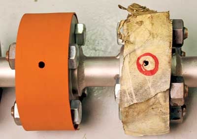

The potential time savings are considerable. If it requires 30 minutes per flange to apply tape to a frame-size turbine, then that’s a savings of perhaps 30 man-hours. During a recent outage, one user reported saving another 96 man-hours cleaning tape from flanges when using Flange Band-It seals.
Not only does Flange Band-It simplify the leak detection process, but it also allows highly trained technicians to focus on important start-up tasks rather than menial chores like scraping off well-done tape (Figure 6).
6. Big timesaver. t's a waste of valuable technician time to scrape tape from flanges—perhaps as much as 15 man-days during a frame turbine outage. Courtesy: Flange Band-It LLC
