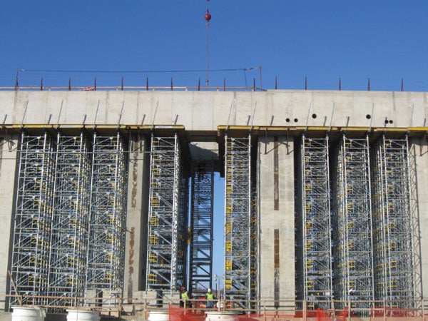

6. Flexible towers. A load-bearing tower, Staxo 100, was chosen because it could deliver high load capacity; was adaptable to different layouts, floor shapes, and loads; and included integrated safety features. Courtesy: Doka USA
Supporting High, Heavy Loads
Doka USA used Staxo 100 high-load-bearing towers to support the massive concrete pour along with Dokamatic tables to form the 5,600–square foot slab. This particular formwork system was chosen because it could deliver high load capacity; was adaptable to different layouts, floor shapes, and loads; and included integrated safety features. The Staxo 100 load-bearing tower is made of sturdy galvanized steel frames and provides an optimal load capacity of up to 90 kip per tower (Figure 7).

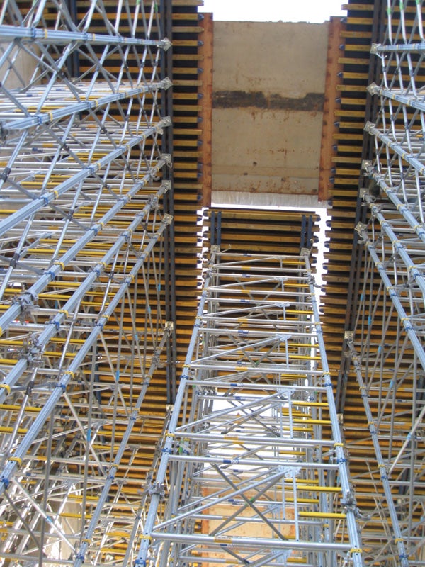

7. Safe and secure concrete pours. Safety was a key concern with the height of this project. Safe access at any location anywhere within the tower using the first built-in ladder and OSHA-approved tie-off points was a selling point for the contractor. Courtesy: Doka USA
Safety was a key concern given the height of this project. Safe access at any location anywhere within the tower was possible by using the first built-in ladder and Occupational Safety and Health Administration (OSHA)–approved tie-off points. These safety features were a strong selling point for the contractor.
Wilhelm’s crew found the shoring system provided quick and easy assembly: Because it used integrated couplers, there were no loose parts. Crews could easily assemble and disassemble the structures. Safety was carefully designed into the erection sequence, as the crew was able to use the integrated ladder and tie-off points that are directly built into the frames. On this project, all three heights of Staxo 100 were used; 3-, 4-, and 6-foot heights.

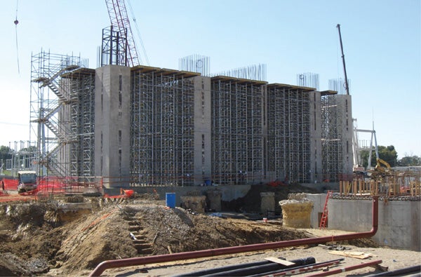

Using Dokamatic tables saved on labor and crane time, because the system is optimized for minimal forming times on large deck projects. Fully assembled table form units quickly position into place and eliminate the need for labor-intensive carrying of individual components from one location to the next. The Dokamatic tables allow for quicker cycle time and are ideal for fast formwork handling when casting large floor slabs (Figure 8).
8. Overhead concrete pour. The contractor chose to use the Staxo 100 high-load-bearing tower to support the 4.8 million pounds of concrete and steel, along with Dokamatic tables to form the 5,600-square-foot slab. Courtesy: Doka USA
Using a simple pin connection, Staxo 100 connects directly to the steel stringer of the table unit and allows flying of a large deck formwork section in combination with the Staxo 100 shoring system. The combination of the Staxo 100 shoring system and Dokamatic table slab formwork allowed 90% of the work to be performed on the ground at a safe level and then lifted into place by a crane.
