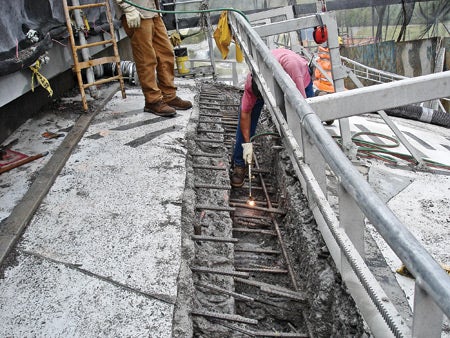

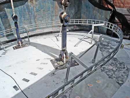

The demolition process began with the installation of a debris barrier system inside the 2-foot-thick concrete dome roof. Next came the installation of a special fixture (Figure 1) designed to keep the water jet perpendicular to the dome roof at all times, regardless of location. The water jet then was used to cut a 30- to 36-inch-wide path about 8 inches deep around the 45 x 22-foot circumference of each concrete section to be removed. The depth of the cut was chosen to leave the steel reinforcing bar (rebar) structure intact.
1. For the super soaker. North American Services Group designed a fixture that keeps the 20,000-psi water jet perpendicular to the containment dome at all times. Courtesy: North American Services Group
NASG also designed and built two other custom fixtures. One attached to the concrete slabs to facilitate their removal. The other held a 200,000-lb "plug" in place while rebar was cut loose from the dome roof (Figure 2). The hydro-demolition phase of the project was completed in five days, three days ahead of schedule.
2. What lies beneath. An 8-inch-deep cut through the concrete reveals the rebar. Courtesy: North American Services Group

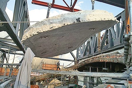

The concrete slabs removed from the top of the containment building weighed over 100 tons apiece. They would challenge any crane, especially at the Watts Bar project because of the height and boom reach required for this project (Figure 3).
3. Pull the plug. The 100-ton concrete plug was lifted by a crane after the rebar was cut away. Courtesy: North American Services Group

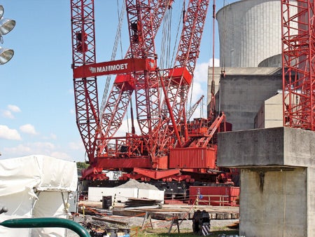

Not taking any chances, TVA reserved one of the world's largest mobile cranes from Mammoet (www.mammoet.com), perhaps the world leader in turnkey heavy-lift crane rentals. The crane made its way by ship and truck from the Netherlands to Tennessee as more than 100 tractor-trailer loads of individual parts that were then assembled on-site. According to Fogarty, it more than earned its keep, doing double duty on SGs as well as concrete slabs and plugs (Figure 4).
4. World's largest. A containerized crane was shipped from the Netherlands to handle the very heavy lifting. Courtesy: North American Services Group
