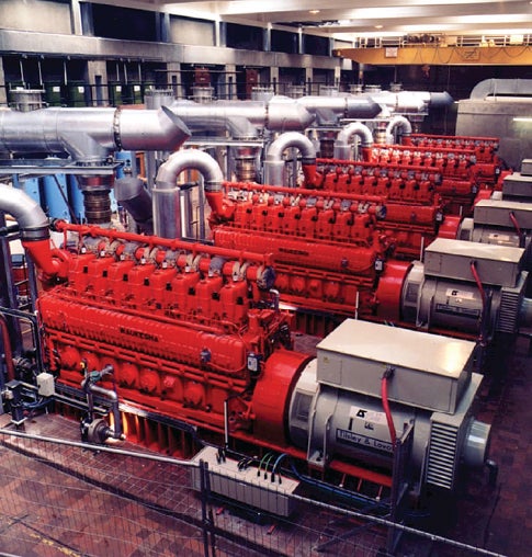

Dresser Waukesha is a familiar name associated with large, gas-fueled stationary engines for power generation and gas compression applications around the world. Each new project location presents a unique set of site variables that must be taken into consideration—such as fuel quality, air/fuel ratio, temperature, humidity, altitude, load, and exhaust after-treatment—when providing the customer a meaningful performance guarantee. To fully characterize every engine option with such a wide range of fuel types and quality and in widely varying environmental conditions across the global is an impossible chore (Figure 6).
6. Sweet sixteen. In this typical cogeneration plant consisting of five 16-cyclinder gas engines, heat is recovered in an exhaust heat-recovery unit and from the jacket water and lube oil. Source: U.S. Department of Energy
