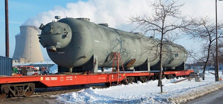

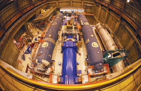

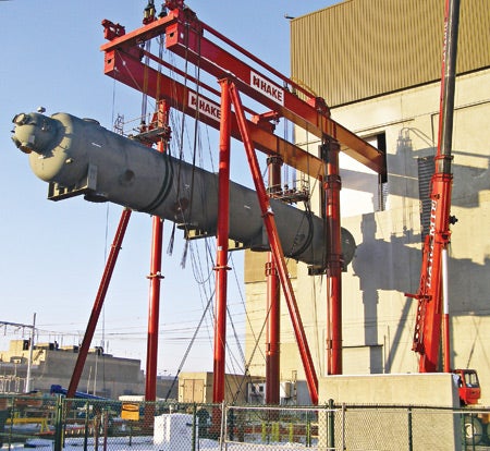

A team consisting of representatives of the Fermi 2 staff and Washington Group was formed to manage the MSR replacement project upon its approval in January 2003. Pre-outage work at the plant began in September 2005. The MSRs arrived on site in December 2005 (Figure 1) and were lifted to the turbine deck elevation by a heavy-lift tower that spanned the railroad tracks (Figure 2). They then were transferred to the plant by overhead bridge cranes and moved to in-plant staging locations (Figure 3). Outage work began on March 25, 2006, and was completed on May 2. The MSR project was a part of a large refueling outage during which Washington Group undertook a number of other challenging projects.
1. Oversize load. A new moisture separator reheater (MSR) arrived at the project site during freezing winter temperatures. It spanned two rail cars. Courtesy: Dave Mitchell, DTE Energy photographic services
2. Heavy hitter. One of the two new MSRs being lifted to the temporary construction access panel and onto the turbine deck for staging. Courtesy: Dave Mitchell, DTE Energy photographic services
3. Bird’s eye view. The turbine deck with the old moisture separator reheater (far right) and the new MSRs on each side of the generator. Courtesy: Dave Mitchell, DTE Energy photographic services
Weather conditions also presented a challenge. Construction of the heavy lift tower and movement of the vessels occurred in unusually cold and windy conditions, with temperatures in the single digits and the wind chill well below zero.
