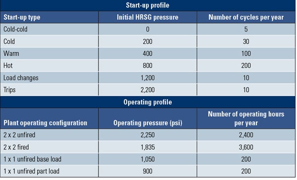

The design of every heat-recovery steam generator (HRSG) begins with a life-cycle analysis (LCA) using very specific plant operating procedures and owner-specified operating profiles that include number of starts, start-up ramp rates, number of load swings and shutdowns, and operating pressures (Table 1). In actuality, few owners are capable of accurately projecting these statistics over a 30-plus-year life cycle. The assumed inspection and maintenance programs in the conventional LCA for the typical combined-cycle plant are based on fixed periodic intervals and statistical information derived from baseloaded units. But an inspection and maintenance program for any unit should take into account the actual operation of the HRSG, not merely the theoretical operating profile. Deviate from those design assumptions, and the actual life of critical components may be severely compromised.
Table 1. The customer specifies the plant operating profile. The heat-recovery steam generator (HRSG) purchaser will normally specify the operating profile of the equipment purchased. A typical operating profile of a 2 x 2 combined-cycle plant with supplemental HRSG firing is illustrated. Source: Vogt Power International Inc.
