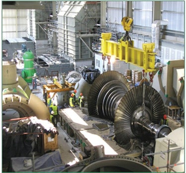

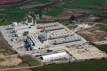

Close to Arcos de la Frontera, in the southern Spanish province of Cádiz, Iberdrola recently placed into commercial service the Group III 800-MW power block, featuring two General Electric (GE) Frame 9FB gas turbines (Figure 1). The project began six years ago with the acquisition of a 400-MW combined-cycle plant under development by Abengoa Group. That was followed by the purchase of a 1,200-MW project being developed by an Enron subsidiary. By early 2003, Iberdrola was granted permission to construct the 1,600-MW Arcos de la Frontera (Arcos) plant. At an estimated cost of 800 million euros (about $1 billion at current conversion rates), Arcos (Figure 2) is the largest and most expensive power plant Iberdrola has built in its 100-year history.
1. First in line. The newest member of General Electric's gas turbine stable is the Frame 9FB, shown here in one of the two Arcos de la Frontera Group III power blocks. Courtesy: Iberdrola
2. Reign in Spain. Iberdrola commissioned the 800-MW Arcos III power block last December, making the 1,600-MW combined-cycle plant the largest of its kind in Spain. Courtesy: Iberdrola
Phase A (consisting of Arcos I and II) went into commercial service in 2004. During that year, Iberdrola also started up the 400-MW Santurtzi combined-cycle plant, for an annual total of 1,200 MW. Phase B of the Arcos III plant and a 400-MW plant in Aceca, Toledo, added another 1,200 MW of combined-cycle muscle to Iberdrola's portfolio the following year. If the 800-MW Escombreras plant is commissioned this year as expected, Iberdrola's total increase in combined-cycle capacity over the past three will be a whopping 3,200 MW.
