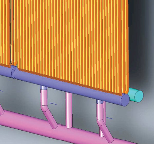

1. High local turbulence at low-pressure (LP) evaporator lower headers. At a large horizontal gas path HRSG, extensive flow-accelerated corrosion (FAC) damage was found at riser piping to the lower headers from the downcomer manifolds and at the tube-to-header weld above these risers (purple area). The plant had high duct firing capability, and steam production was very high. The damage occurred only in the leading LP evaporator panels with the highest heat input (flow rates). FAC damage was not found at the header at the lower bends, a short distance away. Source: Tetra Engineering Group

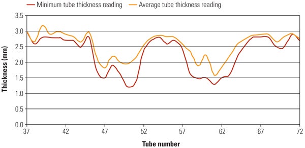

2. FAC damage found in lower LP header area. Readings of the average and minimum tube thickness were taken with nondestructive testing tools at another plant. The data show the observed wear in one-half of the LP evaporator (two modules wide). The peak wear is directly above the riser piping and decreases as you move away. Not shown in the figure is that the location of peak wear on the tube was away from the source of fluid flow. This indicated that the local turbulence was caused by the flow impacting on the side of the tube/header orifice. Source: Tetra Engineering Group

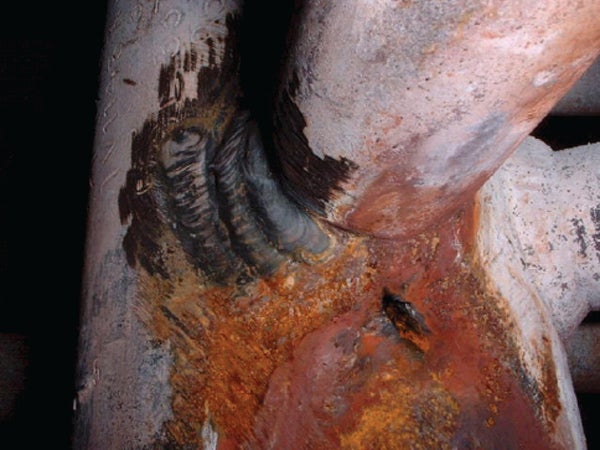

3. FAC damage to LP evaporator header. At this plant, a vertical gas path HRSG suffered localized FAC damage to the header and tube of the LP evaporator section. FAC damage to the header is evident. Courtesy: Tetra Engineering Group

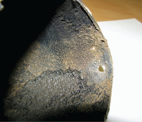

4. FAC damage to tube interior. Looking inside of a header tube shows FAC damage that occurred at tube bends. Courtesy: Tetra Engineering Group

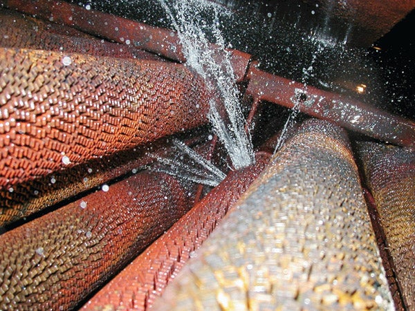

5. FAC leak in tube mid-span. Another example of isolated FAC damage is this case of a rare mid-span tube leak. The cause was found to be local turbulence originating with a poor weld joining two lengths of tube. Courtesy: Tetra Engineering Group
