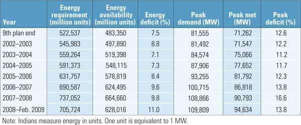

Correction: One unit used to measure energy requirement and availability in Table 1 is equivalent to 1 kWh, not 1 MW as stated in the note.
Table 1.    A generation gap. Since 2002, when the government’s 9th plan ended, the gap between energy availability and requirements has widened, and peak demand continues to soar. India will need to add 92,000 MW before 2012 to eliminate these deficits and meet its economic goals. It has only planned to add 78 GW, however, and even this goal is unlikely to be met. Note that peak met and energy availability represent net consumption (including transmission losses). Sources: Economic Survey 2007; Central Electricity Authority

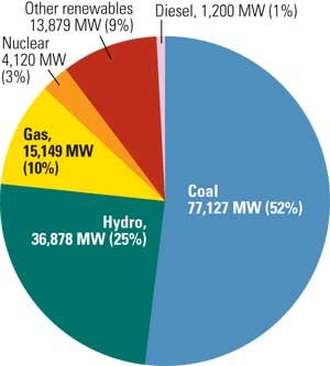

Securing its fuel supplies will be another primary consideration. Today, more than 50% of India’s power is generated with coal, and 10% is natural gas – fired (Figure 1). But, though India has the world’s fourth-largest reserves of coal and has recently made important gas discoveries, the power sector routinely suffers acute shortages of quality coal and gas. Because coal power’s dominance is unlikely to subside, as the Planning Commission recognizes, the country must step up coal production or importation and expand supply of the fuel to more than 2 billion tonnes (2.2 U.S. tons)/year based on the quality of domestic coal.
1.    Fueling growth. Coal dominates India’s 148.4-GW power generation portfolio. According to Planning Commission scenarios, by 2030, coal-fired capacity will likely be in the range of 200 GW to 400 GW, up from the 77 GW today. Source: Central Electricity Authority, “Power at a Glance”; Ministry of New and Renewable Energy

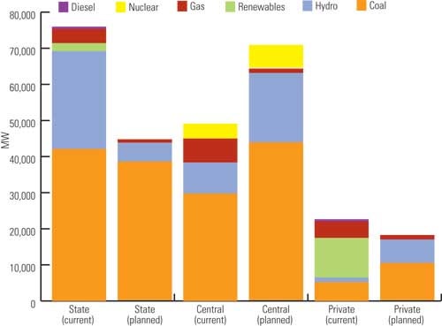

4.    Sharing power.
Though it was liberalized almost 20 years ago, India’s power sector continues to be dominated by the government. Today, state governments produce 52% of the nation’s power, followed by the central government (34%) and the private sector (15%). Source: Central Electricity Authority
State governments produce 52% of the nation’s power, followed by the central government (34%) and the private sector (15%). The industry’s other major players are also central government – owned: The National Thermal Power Corp. (NTPC), for example, accounts for 28% of the country’s capacity, while the Nuclear Power Corp. of India (NPCIL) owns all 17 existing nuclear power plants. The Ministry of Power also oversees key organizations like the national grid operator, Power Grid Corp., and the Central Electricity Authority (CEA), which conducts techno-economic assessments. The coal sector is also dominated by public sector institutions — as is the electric power technology manufacturing sector. Bharat Heavy Electrical Ltd. (BHEL), a holding company overseen by the Ministry of Heavy Industry, manufactured more than 60% of the generation units installed in the 1970s, and it will build many of the power plants planned in the coming decades.
