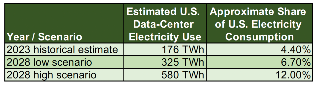

Scale intensifies the difficulty. Lawrence Berkeley National Laboratory (LBNL) estimated that U.S. data centers consumed 176 TWh of electricity in 2023, about 4.4% of total U.S. electricity consumption. Depending on demand growth, efficiency, and broader economic conditions, LBNL estimated that data-center electricity use could reach 325 TWh to 580 TWh by 2028, or roughly 6.7% to 12% of projected U.S. electricity consumption that year (Table 1).
data-center-electricity-use
Table 1. U.S. data-center electricity use, historical and projected. Source: Lawrence Berkeley National Laboratory, 2024 United States Data Center Energy Usage Report
These figures require careful use. A projection is not an obligation to build. A request for service is not the same as energized load. A queue entry is not the same as a financeable project. Some announced data-center demand may be delayed, downsized, relocated, served behind the meter, or never built.
Uncertainty, however, sharpens the planning problem. If utilities and grid operators assume too much load will materialize, they risk overbuilding infrastructure and shifting costs to existing customers. If they assume too little, they risk underbuilding and facing reliability, congestion, or economic-development consequences. The planning challenge is to distinguish among speculative, proposed, mature, contracted, staged, flexible, self-supplied, and energized load.

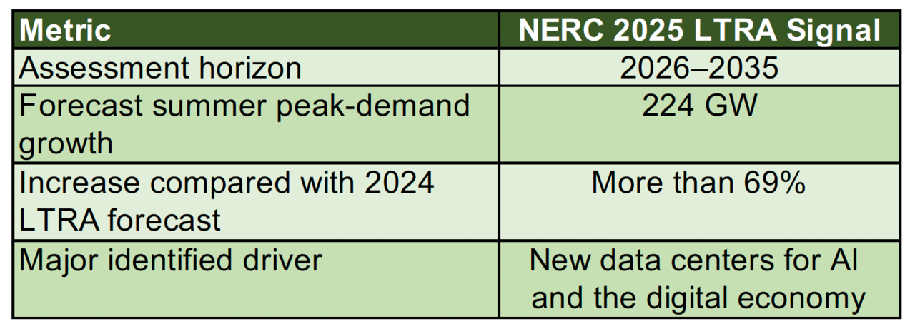

The North American Electric Reliability Corporation’s (NERC’s) 2025 Long-Term Reliability Assessment (LTRA) forecast that summer peak demand would grow by 224 GW, a more than 69% increase over the prior LTRA forecast, with new data centers for AI and the digital economy identified as a major contributor (Table 2). The implication is not that every region faces the same risk or that every data-center announcement will become actual load. The implication is that load growth is now large enough, uncertain enough, and regionally concentrated enough to require more disciplined planning categories.
NERC-LTRA-data
Table 2. The North American Electric Reliability Corporation (NERC) 2025 Long-Term Reliability Assessment (LTRA) demand-growth signal. Source: NERC
Reserve margins remain important, but they do not capture everything planners must manage. A region may show adequate capacity and still face risk if resources cannot run during extreme weather, if fuel is constrained, if transmission cannot deliver power into a load pocket, if imports are unavailable, or if storage duration is insufficient for the event.

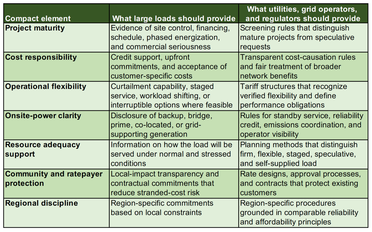

A Practical Large-Load Compact
A practical large-load compact begins with a simple premise: AI data centers and other major loads are neither ordinary customers nor inherent threats. They are large, fast-moving, operationally consequential customers whose decisions now affect the system around them.
That requires a reciprocal planning relationship (Table 3). Large customers should receive clearer and faster pathways to service. In return, utilities, grid operators, regulators, existing customers, and communities should receive better information, firmer commitments, enforceable flexibility, fair cost responsibility, and operational visibility.
large-load-compact
Table 3. A practical large-load compact. Source: Emeka N. Obikwelu, PhD, PE, PMP
Project maturity is the first requirement. A large-load request should not be treated as actionable demand merely because it is large.
Cost responsibility is the second. Customers that drive customer-specific facilities should expect to bear those costs, while regulators should explain when broader network benefits justify shared costs.
Flexibility is the third requirement. Some data-center loads may be able to curtail, stage service, shift workloads, or use onsite resources during stressed periods. That flexibility must be verified, measured, and enforceable.
Onsite-power clarity is the fourth requirement. Backup power is not prime power. Bridge supply is not market-facing generation. A co-located resource is not automatically disconnected from the grid’s obligations.
Community and ratepayer protection is the fifth requirement. Existing customers should not become the default backstop for speculative, poorly structured, or inadequately secured projects. Communities should understand the local power, water, land, fuel, environmental, and emergency-service implications before major commitments are made.
Regional discipline is the final requirement. The Electric Reliability Council of Texas’s (ERCOT’s) Batch Zero process is one example of a region attempting to impose structure on a large-load request pipeline. According to ERCOT, it is tracking more than 438,000 MW of large-load requests, nearly 89% from data centers, and Batch Zero is intended to group qualified large-user applicants into a new study process. That request volume should not be read as committed demand, but it shows why screening, maturity requirements, onsite-generation treatment, and curtailment pathways are becoming central to planning.
