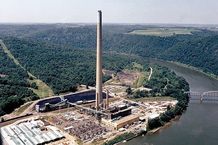

Allegheny Energy's Armstrong Power Station (Figure 1) has two units rated at about 190 MW (gross) each. The station receives coal by truck from a number of local mines, as well as Virginia coal delivered by rail. Two electrostatic precipitators (ESPs) in series control particulate emissions. As a result, Armstrong's stack opacity is very low, typically in the 3% range. Although the plant normally runs in baseload mode, it occasionally is used to help control grid frequency.
1. The tests' host. Armstrong Power Station in Adrian, Pa., has two coal-fired units, each with a gross rating of 190 MW. Courtesy: Allegheny Energy Inc.
Units 1 and 2 at Armstrong discharge flue gas to the atmosphere through two 1,000-ft steel stacks enclosed in a common concrete liner. The 14.5-ft diameter of each stack makes the average flue gas velocity about 75 ft/sec at full load. The main CEM platform, about 350 ft above ground level, is accessible by an elevator.
