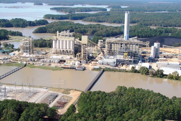

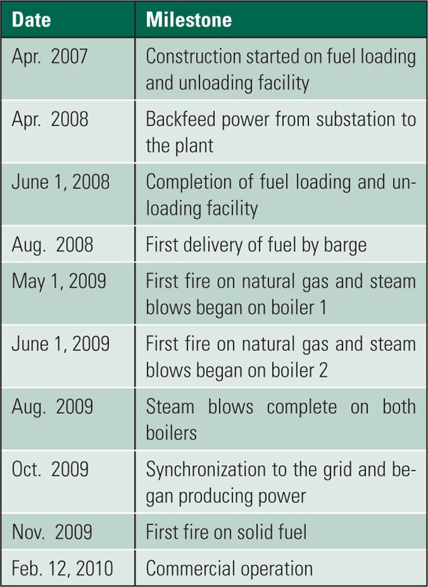

  • Announcing in July 2005 the planned construction of the new $1 billion, 600-MW net Madison Unit 3 solid fuel–fired plant, which entered commercial service in February 2010 (Figure 1). Key plant construction milestones are summarized in Table 1.
1. Best in class. Cleco Power spent about $1 billion to construct the 600-MW Madison Unit 3 solid fuel–fired unit, which entered commercial service in February 2010. Madison Unit 3 is the largest circulating fluidized boiler plant in North America that burns 100% petroleum coke. Lake Rodemacher (also known as Cleco Lake) is used by sportsmen and provides cooling water for the three units at the plant. Courtesy: Cleco Power
Table 1. Madison Unit 3 key dates. Source: Cleco Power
