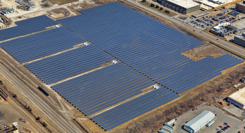

Inovateus Solar, a solar energy provider based in South Bend, Indiana, helped redevelop a site in Kokomo, Indiana, that for years housed a manufacturing plant operated by Continental Steel Corp. The 7.2-MW Kokomo Solar 1 array is located on land where a Continental facility produced nails, rods, wire, and fencing from scrap steel, operating through the Great Depression, and providing materials for the military during World War II.

Kokomo Solar 1 is sited on about 26 acres southwest of downtown Kokomo. The project has a 20-year power purchase agreement with Duke Energy Indiana. Inovateus built the solar farm along with Alterra Power, which was acquired by Innergex Renewable Energy in 2018. Innergex holds a 90% interest in the project, with Inovateus owning the remaining 10%.
The project includes 21,348 Suniva 335-watt DC panels, along with five Ingeteam PowerMax 1110TL inverters. The racking is a Schletter FS Uno fixed-tilt system; Schletter is a Germany-based global solar energy equipment supplier. Inovateus is responsible for Kokomo Solar’s operations and maintenance, including maintaining the brownfield cap, mowing the grass, and regularly checking the solar array for technical issues and maintenance.

1. Inovateus ensured that the solar installation would not disturb the soil cap by working with the U.S. Environmental Protection Agency to design an above-ground, ballasted racking foundation for the Schletter FS Uno fixed-tilt solar racking system. The ballasts ensured that the soil cap would not be penetrated by a typical racking foundation. Courtesy: Inovateus Solar
Part of the site’s remedy is a 24-inch soil cap. A restrictive covenant limits operator liability as long as the cap is maintained and any work on the site is pre-approved. As part of the approval process, the developers had to ensure the solar project would not disturb a section of the soil cap with the rack’s piles. If they did, Inovateus would be required to leave the posts in the soil after decommissioning. Inovateus Solar worked with the EPA to design a fixed-tilt ballasted racking foundation (Figure 1) for the solar panels that allowed the racks to be installed above ground, minimizing their impact on the cap and avoiding permanently installing the piles at the site.
