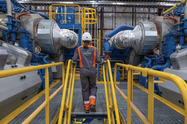

Wärtsilä has similarly captured significant market share in the data center segment. The company announced an order for 24 Wärtsilä 50SG engines (Figure 1) delivering 429 MW of output for an American power plant serving a data center, the equipment destined for an investor-owned utility. In a separate Texas project, Wärtsilä will deliver generating sets for a 123-MW power plant in Odessa, which will become the largest Wärtsilä 31 installation in the world when commissioned. The company will operate and maintain the facility under a 10-year agreement.
1. Wärtsilä has been awarded an order to supply engines for an American power plant owned and operated by an investor-owned utility. This order is for 24 Wärtsilä 50SG engines delivering an output of 429 MW. Courtesy: Wärtsilä Corp.

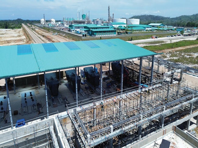

In Malaysia, Everllence is supplying a cumulative 240 MW of engine capacity across three power plant projects on Borneo (Figure 2). The installations highlight the company’s role in supporting the country’s ambitious decarbonization targets, with climate neutrality to be achieved by 2050 primarily through expansion of hydropower and solar energy. In markets traditionally dominated by gas turbines, engine power plants are gaining importance due to their short response times and high efficiency at partial loads.
2. The location of the 52-MW power plant in Sipitang, Sabah, Malaysia. Courtesy: Everllence
