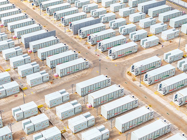

1. Across Europe, a growing number of grid-connected battery energy storage system (BESS) assets are financially idle, tethered to saturated markets by software that can’t keep up. Courtesy: Sympower/iStock
In addition, a more insidious form of inactivity is appearing: assets that are fully connected to the grid but remain financially idle. These are batteries tethered to saturated markets, managed by software that lacks the agility to pivot. This creates a critical inflection point for existing projects (Figure 1). Many current owners are realizing their internal teams or trading and optimization partners are fundamentally unequipped for the current rapidly transitioning market. Reliance on small, non-specialized internal desks or legacy partnerships has become a primary driver of underperformance. Whether an asset is waiting for a cable or waiting for a bid that will never clear, the result for the investor and the grid is the same: zero.

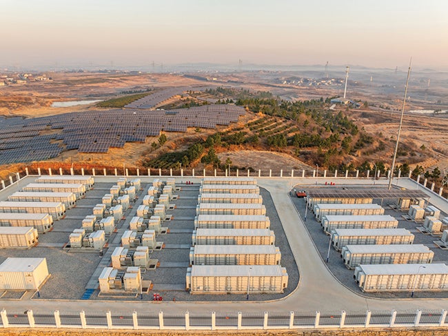

2. In 2026, the most advanced operators are treating BESS assets as financial instruments, stacking value across day-ahead, intraday, and balancing markets. Courtesy: Sympower/iStock
The DA auction is typically the baseline of the trading strategy, during which an operator might commit a portion of the battery, say 40%, to lock in a baseline spread. This provides a guaranteed floor for the day’s revenue, which is also the simplest step.
The real challenge is improving on this floor, constantly re-optimizing up to seconds before activation through additional markets. As weather forecasts shift or wind production ramps up unexpectedly, ID prices often diverge significantly from DA prices. A smart software platform will re-optimize the battery’s position: if the ID spread is wider than the one locked in during the DA auction, and there is sufficient liquidity, the software may effectively sell its DA position back to the market and take a new, more profitable ID position.
The complexity intensified in late 2025 with the European shift to 15-minute Market Time Units (MTUs). By breaking the trading day into 96 windows instead of 24, the market unlocked roughly 14% more revenue potential for flexible assets. This also increased micro-cycling stress: modern optimization must be degradation-aware, weighing quick profit against the risk of voiding a warranty. An aggressive software strategy might capture a high-value price spike today, but could shorten its life by years. That’s why the battery’s health status should be continuously monitored, and the trading strategy adjusted accordingly to ensure battery longevity isn’t shortened and profitability isn’t at risk.
