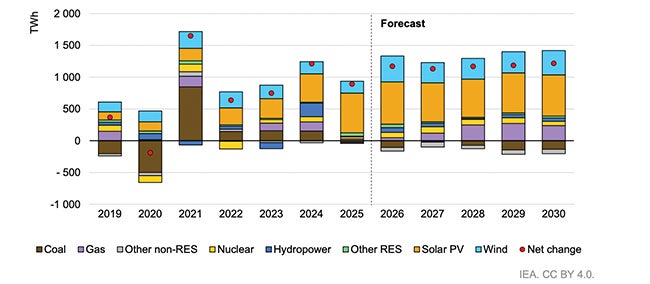

1. Global gas-fired power generation is projected to grow 2.6% annually from 2026 to 2030, driven by strong expansion in the U.S. and rising electricity demand in the Middle East, where countries such as Saudi Arabia are accelerating oil-to-gas switching. Courtesy: International Energy Agency, Electricity 2026 (February 2026)
According to the International Gas Union (IGU), gas-fired generation for data centers could expand by approximately 30 billion cubic meters by 2030 and nearly double again by 2035. The International Energy Agency (IEA), meanwhile, projects that gas-fired generation could grow at 2.6% annually through 2030—the only fossil fuel that is expected to soar in its outlook—as one of the only viable firm, flexible resources that is already balancing grids that are increasingly dependent on variable renewables (Figure 1).
