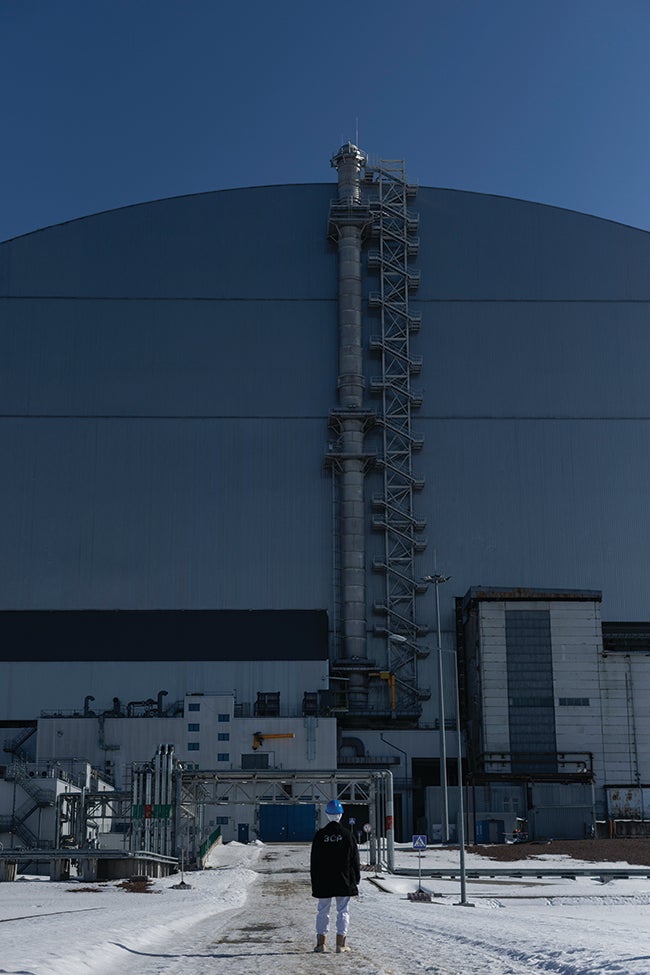

1. The immense steel arc of the New Safe Confinement (NSC) towers above surrounding industrial structures as Chernobyl’s Category 1 specialist in public and press relations, Hanna Pidhaina, surveys the scene. Source: Jack Goras

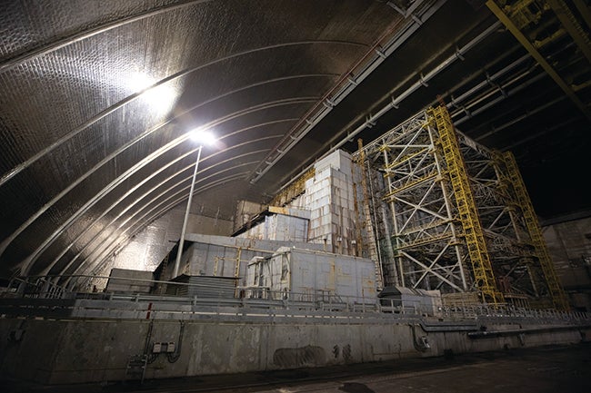

The immediate priority after the accident was to stop the release. Over the first 10 days, helicopters dropped some 5,000 tonnes of boron, dolomite, sand, clay, and lead onto the burning core. By October 1986, a massive concrete shelter—the “sarcophagus”—had been erected around the destroyed reactor in a remarkable feat of emergency construction (Figure 2). But the structure was never intended to be permanent. Built hastily under extreme radiation conditions, it was designed for a service life of 20 to 30 years. About 200 tonnes of highly radioactive fuel-containing material remained entombed within it, and as years passed, concerns grew about the sarcophagus’s structural integrity under the relentless assault of high radiation levels.
2. A concrete object shelter was built quickly over the Unit 4 reactor following the disaster in 1986. It is now enclosed itself within the NSC. Source: Jack Goras
In 1997, the G-7 nations, the European Commission, and Ukraine agreed to fund the Chernobyl Shelter Implementation Plan, managed by the European Bank for Reconstruction and Development (EBRD). The centerpiece was the NSC—a colossal arch-shaped steel structure spanning 260 meters (m, 853 feet), standing 110 m (361 ft.) high, and stretching 165 m (541 ft.) long. At 36,000 tonnes, it became the largest moveable land-based structure ever built. To protect construction workers from radiation, the NSC was assembled on rails adjacent to the reactor and then pushed 327 m (1,073 ft.) into position over the sarcophagus in November 2016. It was formally transferred to Ukrainian authorities in 2020, with a designed service life of at least 100 years. The overall cost of the Shelter Implementation Plan reached approximately €2.15 billion, funded by 45 donor nations and the EBRD itself.
The NSC is equipped with internal cranes and remote handling equipment designed to eventually allow engineers to dismantle the original sarcophagus and remove the fuel-containing materials from the bottom of the reactor building—the most critical remaining step in eliminating the nuclear hazard at the site. In December 2023, the license for radioactive waste storage within the original shelter was extended through October 2029, with the deadline for completing the dismantling of unstable structures pushed back due to funding shortfalls, the COVID-19 pandemic, and the ongoing conflict.

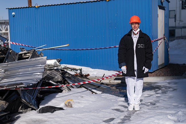

Then, on Feb. 14, 2025, a drone struck the roof of the New Safe Confinement, breaching both the external and internal steel cladding (Figure 3), and creating a hole approximately 6 m (19.7 ft.) in diameter. A fire broke out in the insulation layer between the cladding sheets and smoldered for nearly three weeks before being extinguished on March 7. Radiation levels remained normal throughout the incident. However, a December 2025 IAEA safety assessment confirmed that the NSC had lost its primary confinement capability as a result of the breach, though the load-bearing structure and monitoring systems were undamaged. The EBRD has estimated that repair costs could exceed €100 million, and the structure may not be fully restorable to its original design condition. Temporary repairs are planned this year.
3. Alice Marchuk, a local producer and interpreter, stands beside twisted metal panels in a taped‑off area near the NSC, debris left behind after a February 2025 drone strike that breached the structure and ignited a fire. Source: Jack Goras

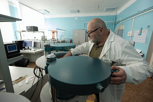

The five-week Russian occupation in early 2022 left physical and institutional scars that are still being repaired. The EcoCenter’s spectrometry laboratory (Figure 5), which had been established in 2015 with European Union (EU) support, was effectively destroyed. Russian troops scattered computers and hard drives across the floor and disabled the facility’s robotic equipment. Monitors and screens were smashed. By all accounts, the occupying forces had little understanding of what they were damaging or of the radiation risks surrounding them—though, notably, no grenades were used, apparently because the soldiers did not know what was stored beneath the facility. Every monitoring system in the laboratory required full restoration. A second phase of EU assistance has since re-equipped the lab with European-manufactured instruments from Canberra and Ortec.
5. The head of the EcoCenter laboratory, Leonid Mikhailovych Bogdan, works with European Union–funded equipment installed as part of the restoration of the lab following its destruction during the 2022 Russian occupation. Source: Jack Goras

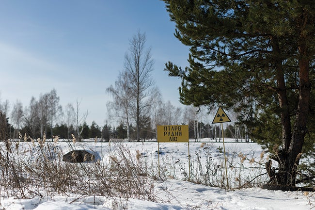

One of the most striking sights in the Exclusion Zone is the lush green forest that now stands where the so-called Red Forest once was. After the 1986 explosion, winds carried radionuclides westward into a stand of coniferous trees that were particularly efficient at absorbing radioactive particles. The pine needles turned yellow, then red, giving the forest its grim name (Figure 6). Military engineering equipment was deployed to uproot the contaminated trees and bury them on-site, creating what was designated a temporary radioactive waste localization site. In the decades since, a new forest has grown over the burial grounds. Visitors are often startled to see vibrant greenery in what they expect to be a wasteland—unaware that the contaminated trees lie buried just beneath the surface.
6. A Soviet-era sign marking the “Red Forest,” one of the most radioactive areas inside the Chernobyl Exclusion Zone, contaminated during the Unit 4 disaster. Nature has since reclaimed much of the area. Source: Jack Goras

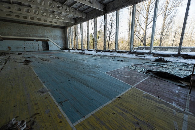

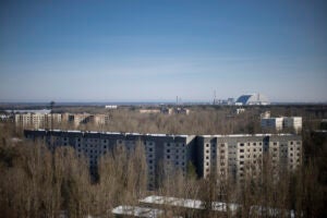

Pripyat itself is a haunting time capsule. Founded on Feb. 4, 1970, the city was only 16 years and 82 days old when the disaster struck. At its peak, it was home to more than 49,000 adults and about 17,000 children—a young city with an average resident age of just 26, growing by 500 to 600 people per year.
By Soviet standards, it was a privileged place. There were no shortages of food or consumer goods, furniture could be obtained without the interminable waiting lists common elsewhere, and career advancement was readily available. The city boasted more than 30,000 rose bushes, earning it the nickname “the city of roses.” The “Energetik Palace of Culture” (Figure 7) featured a concert hall with advanced stage lighting and even hosted a disco that played foreign music, which was officially banned elsewhere in the Soviet Union. Five residential districts, each with three kindergartens and large schools, were planned to support a population that was projected to reach 80,000.
7. Among the modern facilities built for workers in Pripyat was the Energetik Palace of Culture, which included a basketball court, swimming pool, and other recreational amenities. Since the disaster, the site has been vandalized and stands in a state of decay. Source: Jack Goras

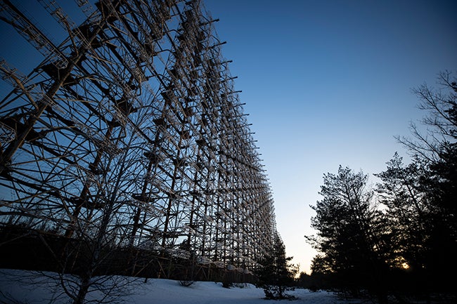

Another Cold War artifact endures within the zone: the Duga radar, a massive Soviet over-the-horizon early-warning system designated 5N32, built between 1972 and 1976 in the secret military town of Chornobyl-2. The system’s two phased-array antennas—the larger standing 150 m (492 ft.) high and stretching 2 km (1.24 miles) long—were powered by the Chernobyl nuclear plant and designed to detect U.S. missile launches at ranges of 900 to 3,000 km (559 to 1,864 miles). Known internationally as the “Russian Woodpecker” for the repetitive tapping signal it broadcast, which interfered with civilian aviation and drew protests from the U.S., the UK, and Canada, the system was abandoned after the 1986 accident. The towering antennas remain (Figure 8), a rusting monument to the overlapping Cold War and nuclear histories embedded in this landscape.
8. The Duga radar, a massive Soviet early warning defense system, stands inside the Chernobyl Exclusion Zone. The once-classified Cold War installation is now one of the zone’s most recognizable landmarks. Source: Jack Goras
