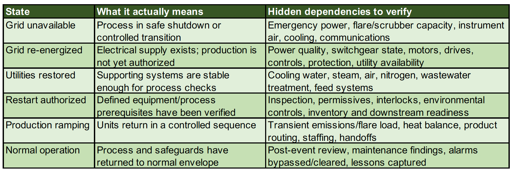

A Restart-Readiness Map
A useful plant-side resilience model treats restoration as a sequence of verified states rather than one timestamp. The exact systems vary by facility, but the control logic can be made explicit.
