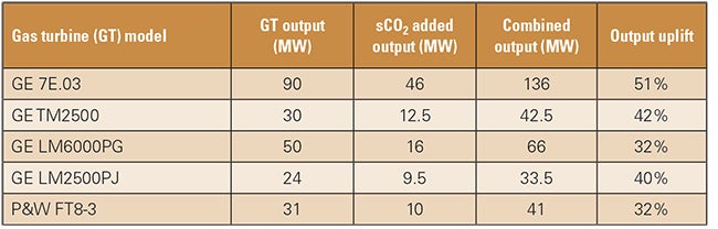

Echogen, using data from Orennia, identified 127,498 MW, almost 95% of the existing SCGT fleet, as potentially eligible for an sCO2 bottoming cycle—a substantial addressable base. Approximately 20% of that capacity comes from the Frame 7E fleet, with the LM6000 family contributing another 11%. Table 1 shows representative output uplift for these and other key turbine models, with combined capacity gains ranging from 32% to more than 50% depending on platform.
Table 1. Supercritical CO2 output figures represent Echogen bottoming cycle estimates. Combined totals reflect simple arithmetic sum; site-specific integration may vary. (Used with permission from Orennia.) Courtesy: Echogen

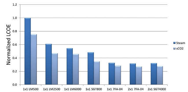

Performance and Operating Cost. Across the 5- to 200-MW+ range, sCO2 systems deliver a 10% to 20% reduction in levelized cost of electricity (LCOE) versus a steam bottoming cycle of comparable output (Figure 1). The advantage is largest at the lower end of the range, where steam-cycle fixed and operating costs dominate.
1. Projected levelized cost of electricity (LCOE) for bottoming cycle power generation, assuming 5% discount rate, 30-year plant life, and 85% capacity factor for several sample applications. Courtesy: Echogen
