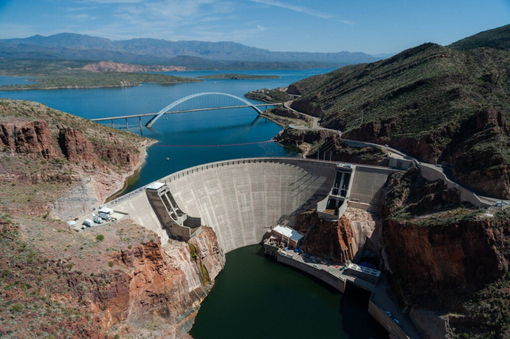

The Theodore Roosevelt Dam on the Salt River in Arizona was initially built more than a century ago. It was upgraded and modified between 1989 and 1996. The facility has 36 MW of hydropower generation capacity. Source: Emerson and Salt River Project
