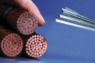

A technological breakthrough in cable technology promises to assist utilities in overcoming both of these problems. The new cable is manufactured using hair-thin high-temperature superconductor (HTS) wires that conduct 150 times the electricity of similar-sized copper wires (Figure 1). When placed in a cable, these superconductor wires act as almost perfect conductors of electricity as long as a few conditions are met, the most notable one being that the temperature of the cable must be maintained below a certain critical temperature. This requires the cable system to be continuously cooled with liquid nitrogen, which is inexpensive and environmentally safe. This also eliminates the oil used in many conventional high-power cables in cities across the U.S.
1. Doing more with less. Hair-thin HTS wires conduct 150 times the electricity of similar-sized copper wires. Courtesy: American Superconductor Corp.
