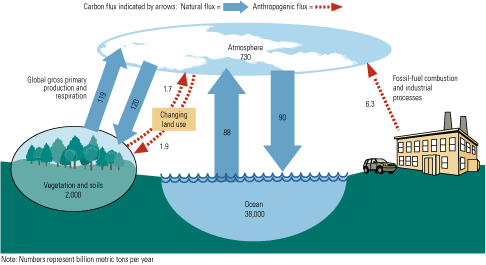

The scale of the problem is daunting. America’s CO2 emissions are more than twice those of Europe and constitute 25% of the world’s CO2 emissions from the burning of fossil fuels as a whole (Figure 1). China is creeping up and may surpass the U.S. as early as next year. U.S. power plants produce about 2.4 billion tons of the heat-trapping gas annually; the transportation sector is close behind at just under 2 billion tons; industry contributes 1 billion tons. A forest covering four million acres (larger than the state of Connecticut) would be required to sequester just the CO2 produced by a 750-MW supercritical coal-fired plant. Yet Grothen said he expects the generation industry to be dominated by coal plants equipped with CCS technologies, and by the next generation of nuclear plants, by 2040.
1. Earth in the balance. The "carbon cycle" describes the movement of carbon between the atmosphere and the land, oceans, and man-made (anthropogenic) sources such as automobiles, industry, and power plants. Source: Intergovernmental Panel on Climate Change, Climate Change 2001: The Scientific Basis
