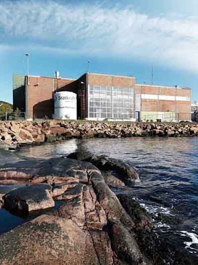

One of the world’s first osmotic power plants started operation at Tofte on the Oslo fjord in Norway last November, producing 2 kW to 4 kW after more than a decade of collaborative research and development by the Norwegian University of Science and Technology and Norwegian state-owned utility Statkraft (Figure 1).
1.     Osmotic power.
Norway’s state-owned utility last November started operation of one of the world’s first power plants to produce 2 kW to 4 kW by exploiting the salinity gradient—or salt differential—between seawater and freshwater. Still in the prototype phase, the plant at Tofte on the Oslo fjord will eventually be expanded to a 1-MW to 2-MW pilot facility. If viable, project results will be used to develop a commercial osmotic power facility by 2015. Courtesy: Statkraft

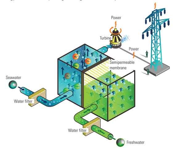

The plant operates on a process called pressure-retarded osmosis (PRO) (Figure 2), which basically involves pumping seawater at 60% to 85% of the osmotic pressure against one side of semipermeable membranes whose other side is exposed to freshwater. When freshwater, compelled by osmosis, flows across the membranes, it dilutes the saltwater and increases its volume — and consequently, the pressure within the saltwater chamber. A generator-driving turbine is spun as the pressure is compensated. (For details of the PRO process see "Osmotic power from the ocean" in POWER, November/December 2006.) PRO can be thought of as the reverse osmosis process (used for desalination and water treatment) running backward and producing power from the flow of freshwater.
2.     A dose of salts. At Statkraft’s recently opened osmotic power plant, freshwater and salt water are guided into separate chambers, divided by an artificial membrane. The salt molecules in seawater pull the freshwater through the membrane, increasing the pressure on the seawater side. The pressure equals a 120-meter water column, or a significant waterfall. That energy is used to turn a power-generating turbine. Courtesy: Statkraft
