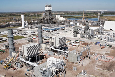

Tampa Electric Co. (TECO) owns and operates Polk Power Station as part of its regulated generation fleet in Central Florida. The plant (Figure 1) occupies 4,300 acres in Polk County, about 40 miles southeast of Tampa. One-fifth of the integrated gasification combined-cycle (IGCC) project’s $600 million capital cost was paid for by the U.S. Department of Energy as part of its Clean Coal Technology Program. Now called Unit 1, the plant was commissioned and placed into commercial service in late 1996. During its first five years of operation, the plant operated successfully on a number of different fuels that were part of the DOE demonstration plan.
1. First in class. Polk Power Station Unit 1 has the lowest production cost of any plant in the Tampa Electric system. Courtesy: TECO

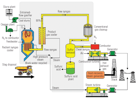

The coal gasification portion of Unit 1 (Figure 2) uses entrained-flow, oxygen-blown technology that was developed by Texaco and later purchased by General Electric Co. Power is generated by a 315-MW 1 x 1 combined-cycle plant whose GE 7FA combustion turbine fires either the output of the gasifier or distillate oil. The turbine is rated at 192 MW when firing the syngas, with diluent nitrogen for NOx control. Complementing the 7FA are a 123-MW GE D11 steam turbine-generator and a triple-pressure heat-recovery steam generator from Vogt Power International (www.babcockpower.com). The oxygen plant consumes 55 MW, and other auxiliaries require 10 MW, so the net power delivered to the grid is 250 MW. The IGCC unit’s heat rate is about 9,300 Btu/kWh on a steady-state basis when firing syngas.
2. Harness the power. Unit 1 produces 315 MW (gross), but the oxygen plant consumes 55 MW, and auxiliaries eat up another 10 MW, leaving 250 MW for delivery to the grid. Courtesy: TECO

3. Go with the flow. A simplified process flow diagram of TECO’s Polk Power Station Unit 1 illustrates the complexity of the IGCC process. Source: U.S. DOE
