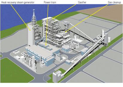

Several additional gasification tests have been conducted since 1998 as design verification testing continued and the data needed to scale up and accurately predict the performance of the demonstration gasifier were obtained. Clean Coal Power R&D Co. Ltd. (CCP) was established in June 2001 to move the earlier NEDO-sponsored development program and the feasibility study results forward into a demonstration project phase. The same sponsors (with the exception of CRIEPI) are participating, and the Japanese government is subsidizing about 30% of the demonstration project’s development costs. The 250-MW "semi-commercial scale" demonstration project (Figure 2) will confirm plant reliability, operability, maintainability, safety, and economics. The final deliverable of the nine-year project will be a design certified for commercial power generation.
2. One giant step. MHI’s 250-MW IGCC demonstration project was scheduled to begin operation and testing last month. Source: MHI
