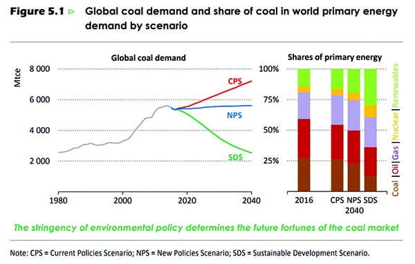

One of the key takeaways of the 2017 WEO is that coal’s hold on the energy sector is likely to falter. As natural gas prices fall, renewables become prevalent, and energy efficiency impacts energy demand significantly, the report finds that absent large-scale carbon capture and storage, global coal consumption will flatline under the New Policies Scenario (Figure 1).
Figure 1_WEO2017
1. Up, down, or sideways. According to the International Energy Agency’s (IEA’s) annual World Energy Outlook, global coal demand could vary markedly through 2040, depending largely on energy policy decisions. If the energy policy landscape doesn’t change at all in the next 22 years, coal demand would continue to grow (red line). However, if announced policy intentions are implemented, the IEA predicts that coal demand would plateau (blue line). If all actions necessary to meet the United Nations’ Sustainable Development Goals are executed, coal demand would plummet (green line). Source: International Energy Agency
