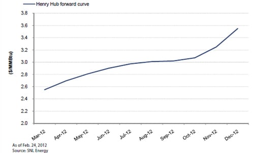

The forward curve for the Henry Hub shows prices rising relatively modestly from spring through summer, flattening from August through October, and then rising more steeply through December (Figure 2). The forward price for the March contract as of Feb. 24 was just over $2.50/MMBtu, with the summer contracts at nearly $3.00/MMBtu and the December contract at nearly $3.60/MMBtu.
2.  2012 NYMEX Henry Hub forward price curve. Source: SNL Energy

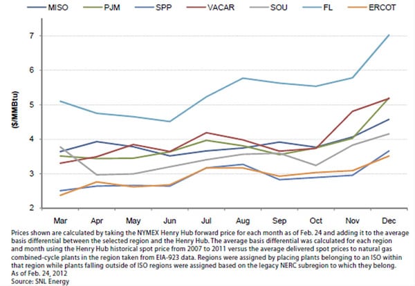

SNL Energy took the Henry Hub forward curve for 2012 as of Feb. 24 and combined it with the monthly average basis differential for each region to approximate the direction for delivered gas costs for the year. This data is solely illustrative and is not meant to serve as a forecast of expected delivered gas costs.
The highest average delivered costs in 2012 could be seen in the FL NERC subregion. Adding Henry Hub forward prices for 2012 to the average basis differential based on delivered gas costs to CCGT plants in the region would yield a price of $5.10/MMBtu in March, reaching as high as $7.02/MMBtu in December.
Using the same forward pricing methodology, the VACAR NERC subregion would see a gas price of $3.31/MMBtu in March [Editor: actual Henry Hub prices in March began at $2.45 and ended the month at $2.00], rising slightly during the summer months and climbing to roughly $5.00/MMBtu in November and December (Figure 3).
3. 2012 NYMEX Henry Hub forward prices with added average delivered cost basis differential for select regions. Source: SNL Energy
Future gas prices calculated for the coal-heavy SOU, or Southeastern, NERC subregion yield a 2012 forward curve that is relatively flat with a price of $3.78/MMBtu in March, falling slightly through the shoulder months of April and May before slowly rising to $4.16/MMBtu in December.
The calculated forward curves for both the New York ISO and ISO New England show prices largely hovering at nearly $4.00/MMBtu for most of the year and climbing to roughly $6.00/MMBtu in December. Calculated forward prices for PJM range from a low of $3.44/MMBtu in April to a high of $5.20/MMBtu in December.

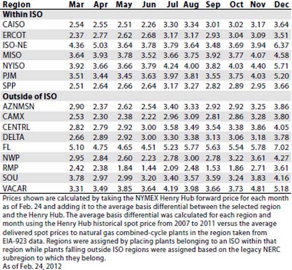

With gas prices so low, interest is peaking in the coal-to-gas switching potential for plants burning coal sourced out of the Midwest and the Powder River Basin (PRB). Plants operating in the Midwest ISO (MISO), where the delivered cost of natural gas to CCGT plants has averaged roughly $1.00/MMBtu higher than the Henry Hub spot price over the past several years, consume much of this coal. The calculated 2012 forward curve created by adding the Henry Hub price to the average basis differential yields forward monthly prices averaging $3.86/MMBtu for March through December and reaching a high of $4.58/MMBtu in December (Table 2).
Table 2. 2012 NYMEX Henry Hub forward prices with added average delivered cost basis differential ($/MMBtu). Source: SNL Energy
A coal-to-gas parity calculation—using current average Illinois Basin spot coal prices, current SO2 and NOx emissions costs, a $9.00/ton coal transportation cost, a $1.50/MWh average variable non-fuel O&M cost, and adjusted for the higher efficiency of a 7,500-Btu/kWh CCGT plant versus a 10,500-Btu/kWh coal plant—yields a gas floor of $4.15/MMBtu. While this gas parity calculation is broad, it indicates a move toward some potential for coal-to-gas switching for plants consuming Illinois Basin coal if actual forward delivered gas costs are in the range of those previously calculated.
A parity calculation for Powder River Basin coal using the same heat rate assumptions and emissions costs, current coal market prices, and a transportation rate of $16/ton yields a gas floor price of $2.42/MMBtu. While individual plant costs may vary, this indicates limited displacement of PRB coal in the Midwest when compared against the calculated forward gas price curve.
