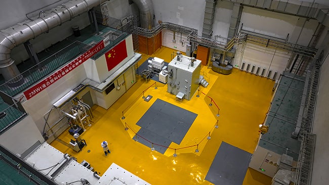

4. The main hall of the 2-MWth Thorium Molten Salt Reactor (TMSR-LF1) experimental facility in Wuwei, Gansu Province. The reactor achieved first criticality in October 2023 and began full operation in June 2024. Courtesy: Shanghai Institute of Applied Physics, Chinese Academy of Sciences |

For now, China’s TMSR-LF1 remains the only operating reactor demonstrating continuous thorium-uranium conversion under real irradiation conditions (Figure 4). According to Chinese publication ThinkChina—though unverified by POWER—China’s plans will reportedly follow a three-step development pathway. After running the 2-MWth experimental reactor, which has now achieved thorium-to-uranium conversion, to gather key data, the second step involves building a 10-MW small modular demonstration reactor by 2029 to verify commercial viability and establish core infrastructure supply chain capabilities. The third step targets construction of 100-MW power stations by 2035, enabling large-scale application in thorium-rich regions such as Gansu and Xinjiang while spurring development of equipment manufacturing, molten salt materials, and related industrial clusters. CAS has said SINAP will work with leading energy companies to consolidate the TMSR industrial and supply chains and “accelerate technology iteration and engineering application.”
