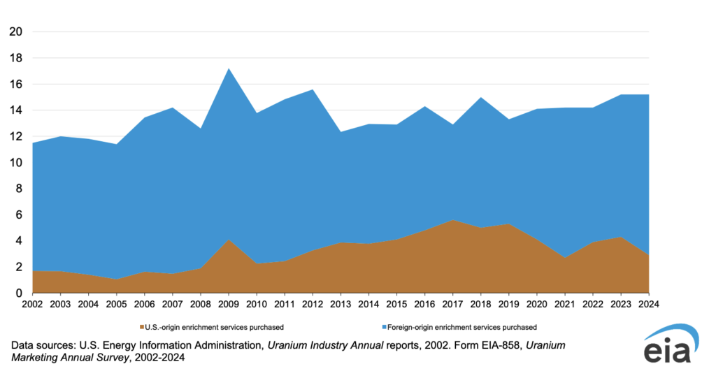

According to the U.S. Energy Information Administration’s (EIA’s) September 2025–released 2024 Uranium Marketing Annual Report, U.S. utilities purchased about 15.2 million separative work units (SWU) of enrichment services in 2024, but roughly 80% was supplied by foreign providers, primarily from Russia and Western Europe, including state-owned supplier Rosatom and multinational firms such as Urenco and Orano. Still, the only large commercial domestic enrichment facility in the U.S. today is Urenco USA’s gas-centrifuge plant in Eunice, New Mexico, operated by Louisiana Energy Services, which has a capacity of about 4.9–5 million SWU per year—roughly one-third of current U.S. fleet requirements, EIA data shows.

Uranium enrichment services purchased by owners and operators of U.S. civilian nuclear power reactors, 2002–2024. Source: EIA (September 2025)
