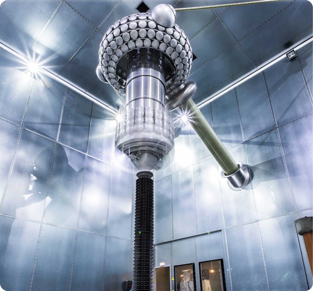

High-voltage instrument-transformer equipment inside a Trench Group test facility.
Trench Group instrument-transformer equipment in a high-voltage test environment. Instrument transformers measure current and voltage in power systems, supplying data used for metering, protection, and grid control. Courtesy: Trench Group

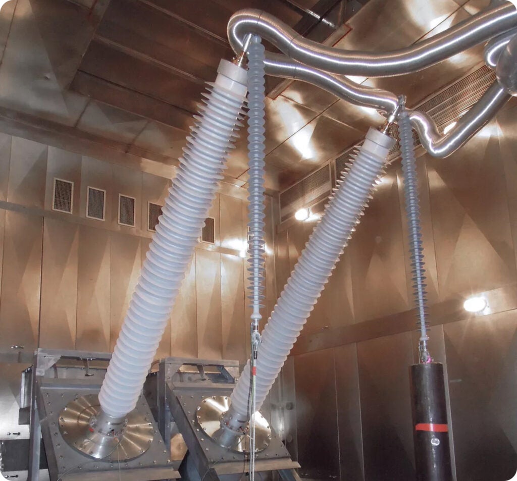

High-voltage bushings installed in electrical test equipment at a Trench Group facility.
Trench Group’s HSP bushing portfolio includes dry-type designs for high-voltage transformer applications. The company’s new Charlotte, North Carolina, facility is its first U.S. manufacturing site and is ramping production for the North American market. Courtesy: Trench Group
