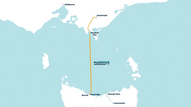

Marinus Link, a new 1,500-MW electricity and telecommunications interconnector between Northwest Tasmania and Victoria’s Latrobe Valley, is currently being developed to connect Tasmania’s renewable energy resources with demand on the mainland. Its route runs for about 214 miles, which includes roughly 158 miles of subsea cable across Bass Strait and 56 miles of underground cable through Gippsland.
The project is being developed in two 750-MW stages, rather than a single 1,500 MW circuit to meet transmission network operation (availability and reliability) requirements in Tasmania and Victoria. Stage 1 is scheduled for completion in 2030. A decision on timing for Stage 2 will be made soon, in line with National Electricity Market transmission planning and demand requirements.
The cable will run from Heybridge, near Burnie, across Bass Strait to Waratah Bay in Victoria. From there, it will continue underground to Hazelwood in the Latrobe Valley (Figure 1). Converter stations at Heybridge and Hazelwood will connect the high-voltage direct-current (HVDC) system with the existing alternating-current (AC) networks in each state.
1. This map shows a simplified route for the Marinus Link. Courtesy: Jacobs

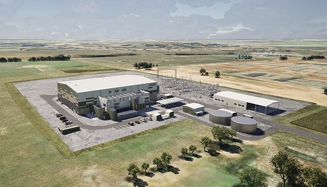

At Hazelwood, the converter station will sit beside the existing Hazelwood Terminal Station in the Latrobe Valley (Figure 2), which has a long history of electricity generation and established transmission infrastructure, and will provide access to Victoria’s 500-kV AC transmission network.
2. This rendering shows the converter station in Hazelwood, Victoria. Courtesy: Jacobs

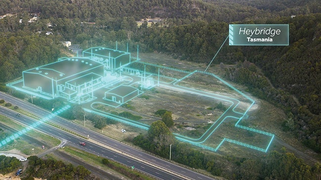

Heybridge follows the same approach. The converter station is being developed on the former site of a titanium dioxide factory near Burnie (Figure 3), where it can connect with Tasmania’s 220-kV AC network.
3. This illustration shows the converter station in Heybridge, Tasmania. Courtesy: Jacobs
Locating both converter stations close to existing transmission assets keeps the new AC connections relatively short and reduces the amount of additional land needed around the endpoints. From there, the engineering challenge moves to the cable system between them.
