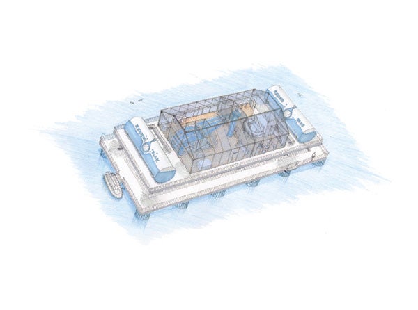

The SEADOG is essentially based on an air-filled buoyancy block within a cylindrical chamber. The chamber stays relatively stationary while the block rises and falls with the waves. The motion of the block moves a piston within a cylinder, drawing in and expelling water with every stroke. By adjusting the piston size, the same size pump can be deployed to pump larger amounts of water to lower elevations, or smaller amounts to greater elevations, the device’s owner, Minnesota-based Independent Natural Resources Inc. (INRI) says.
According to the company, the planned facility will comprise a 150-foot by 75-foot platform installed 1 mile offshore (Figure 7) that will be equipped with 18 wave pumps. Each pump, 7 feet in diameter, will send water up through three water wheels connected to a generator. The pumps themselves will work 25 feet below the surface of the water and be able to generate about 60 kW. About 4 kW of this power will be used to run a standard reverse osmosis desalination machine to produce 3,000 gallons of freshwater per day.
| 7. On the crest of a wave. The SEADOG, an offshore platform planned for installation in the Gulf of Mexico this year, will employ 18 underwater pumps to extract mechanical energy from each wave and use that energy to desalinate water. Courtesy: Independent Natural Resources Inc. |
