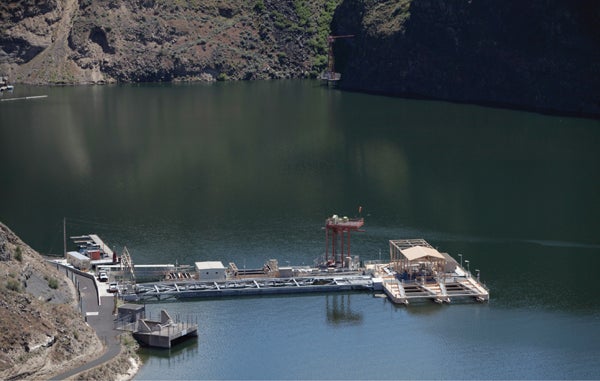

In December 2009, construction of an underwater tower and fish collection structure was successfully completed at the 465-MW Pelton Round Butte Hydroelectric Project. The first-of-its-kind fish bypass and intake structure returns temperatures in the lower Deschutes River to historic patterns and restores downstream passage of Chinook, steelhead, and sockeye salmon while maintaining existing generating capacity.

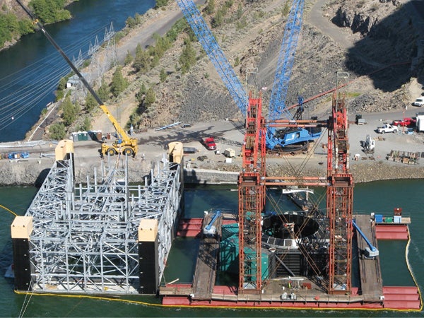

1. Award-winning design. The first-of-its-kind fish bypass and intake structure at the Pelton Round Butte Hydroelectric Project is shown while under construction. The Selective Water Withdrawal Project, which was designed and constructed by CH2M HILL, won the 2011 American Council of Engineering Companies’ national Grand Award. Courtesy: Portland General Electric
