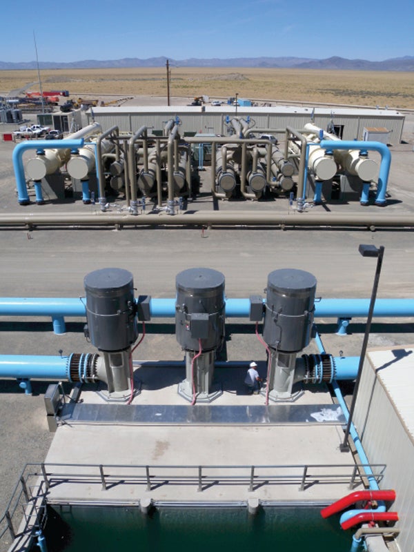

NGP’s Blue Mountain facility is a state-of-the-art binary cycle geothermal plant supplied to NGP by Ormat Technologies Inc. It uses a closed-loop heat exchange system in which hot geothermal fluid is used to heat a secondary fluid that has a lower boiling point. Isobutane, the secondary fluid used at the NGP plant, is vaporized and used to run a turbine and generate electricity (Figure 1).
1. Geothermal energy at work. The view from the cooling tower of the energy converters at NGP’s Blue Mountain Faulkner Geothermal Power Plant in northern Nevada. Courtesy: Nevada Geothermal Power Inc.
