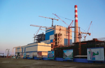

The construction of the Zhuanghe plant (Figure 1) was undertaken in two phases. The first phase, completed in the fall of 2006, provided 1,200 MW; the second phase completed the 3,200-MW plant at the end of last year. During the first phase, the plant drew surface water from a reservoir located 12 miles away. With completion of the second phase, the plant switched over to seawater for all cooling water and boiler makeup needs.
1. Clean sweep. China’s new 3,200-MW Zhuanghe power plant uses seawater for cooling and boiler water makeup. An ultrafiltration system is used for pretreatment because it has a small footprint and provides higher permeate quality to the main (reverse osmosis) plant water treatment system than conventional pretreatment systems. Courtesy: Koch Membrane Systems Inc.

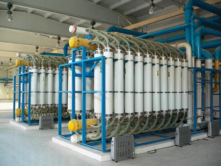

Two trains of UF were commissioned in October 2006, and three additional trains were commissioned at the end of 2007 for the second phase of the plant’s construction. The trains operate in parallel, and each is equipped with 44 cartridges, resulting in a train capacity of 61,000 gallons per hour (Figure 2).
2. Seawater makeup. The ultrafiltration system comprises five trains that operate in parallel. Each has 44 cartridges and a capacity of 61,000 gallons per hour. Courtesy: Koch Membrane Systems Inc.
Prior to the ultrafiltration, the seawater is pretreated by coagulation and sedimentation, both performed in the same tank. FeCl3 or Poly FeSO4 is used as coagulant, and if needed, anionic PAM (anionic polyacrylamide) is used as a coagulant aid. To control biological growth, sodium hypochlorite is added to the feed of the sedimentation tank. The level of controlled free chlorine ahead the UF is about 0.3 to 1.0 mg/l. A 100-μm screen pre-filter that can be automatically backwashed is installed ahead of the UF to remove larger particles.

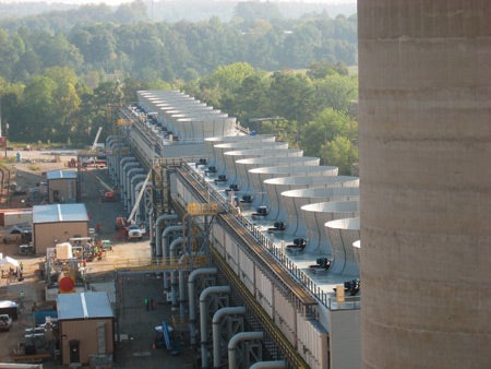

Big benefits to the Chattahoochee River ecosystem are expected from the start-up of two new cooling towers (Figure 3) at Georgia Power’s Plant McDonough in Smyrna. The first tower began commercial operation this March, and the second was expected to follow suit a month later.
3. Some like it cool. Each of the two new cooling towers at Plant McDonough is designed to lower the temperature of the plant’s effluent by 20F. Courtesy: Georgia Power
The $96 million cooling towers represent the end product of an agreement between Georgia Power and the state Environmental Protection Division in 2000 to lessen the environmental impact of water discharged into the Chattahoochee River. “The towers will help to enrich the river’s habitat by improving the dissolved oxygen levels in the river and by allowing the river to better assimilate treated wastewater that is returned to it from upstream sewage plants,” said Chuck Huling, Georgia Power’s VP of environmental affairs.
Georgia Power has installed state-of-the-art plume abatement technology on the towers to reduce evaporation losses and to minimize fogging and misting in nearby areas during cold, damp weather. Each cooling tower is 550 feet long, 73 feet wide, and 55 feet high. Each is designed to lower the temperature of 137,000 gallons of water per minute by 20 degrees F.
“Reducing the temperature of the water discharges from the plant will greatly reduce its thermal effect on the river,” said Tony Tramonte, Plant McDonough’s manager. “Installing these cooling towers was the right thing to do for the river and the region.”
Plant McDonough has two coal-fired units with a total generating capacity of 540 MW. They are scheduled to be replaced in 2012 by three natural gas–fired combined-cycle units that will use the new cooling towers. The new gas units will supply 2,520 MW—more than four times the plant’s current capacity.
