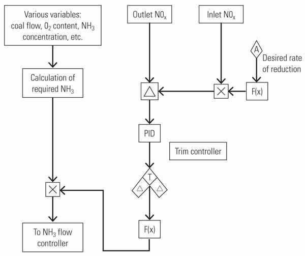

What isn’t simple is determining how much ammonia to use. The amount of ammonia introduced into the reactor is the critical control variable. If less than the amount required to reduce the NOx content to desired levels is injected, the reduction requirements will not be met. If too much ammonia is injected, then the phenomenon of ammonia slip occurs, where costly unreacted ammonia is exhausted to the stack. In some regions of the U.S., the amount of ammonia slip is also part of a plant’s operating permit restrictions. Tight control of the outlet NOx content is, therefore, a major concern for all plant operators.
The core requirement for achieving tight control of NOx is a robust control system that can nimbly respond to either a load or a NOx reduction rate setpoint change. It is well documented that the amount of NH3 injected into the SCR should be directly proportional to the amount of NOx entering the reactor. As a result, the SCR industry has developed a more-or-less standard method of modulating NH3 flow, as shown in Figure 1.
1. The standard. Most coal-fired plants use a more-or-less standard trim controller to determine NH3 demand to control NOx production. Source: Tim Leopold
In essence, this control scheme calculates the unit’s NH3 requirement for a given NOx reduction. The outlet NOx is then compared with a setpoint derived from some function of the product of the required reduction and the measured inlet NOx. This calculation varies in complexity from manufacturer to manufacturer and for different applications, but all are generally variations on this same control scheme.
