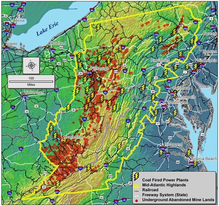

As engineering consultants to the PPRP, Environmental Resources Management (ERM) Inc. has conducted several studies and pilot projects to evaluate and demonstrate the beneficial reuse of CCPs for deep mine stabilization. There are several hundred abandoned underground mines in western Maryland and several thousand across the Mid-Atlantic Highlands (Figure 1).
1. Back to the source. This map shows abandoned underground mine lands within the Mid-Atlantic Highlands. Railroads and interstate highways provide a readily accessible transportation network for moving coal combustion products/by-products (CCPs) to mine reclamation sites. Mines and power plants are typically located along rail and/or highway transportation corridors that are ideal for economical movement of massive volumes of CCP. Source: Environmental Resources Management Inc.

In Maryland and the Mid-Atlantic Highlands, the proximity of abandoned mines to coal-fired plants makes it cost-effective to transport massive volumes of engineered CCPs via the existing network of railroads and interstate highways. The voids in the Maryland mines alone have an estimated total volume of one billion cubic yards, or enough capacity to permanently (and beneficially) dispose of hundreds of years worth of CCPs generated in the state. At present, about 27 million tons of CCPs are produced annually in the Mid-Atlantic Highlands, with Maryland contributing approximately 2 million tons. The rule of thumb is that one ton of CCPs can be turned into one cubic yard of grout.

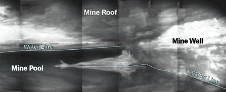

CCP grouts also must be compatible with the often-acidic water in flooded underground mines (Figure 2). They should simultaneously be strong enough to provide control of subsidence and retain the physical and chemical integrity needed to resist dissolution and release of soluble metals. Optimizing the balance between a grout's fluidity and cementitious properties is a key challenge in the engineering of a CCP for reuse.
2. Down periscope.
A panorama from a remote borehole camera shows the underground structures and conditions of the abandoned Frazee Mine in western Maryland. Mine pools often contain acidic water that could ultimately enter surface waterways through seepage or mine wall ruptures. Courtesy: Environmental Resources Management Inc.
