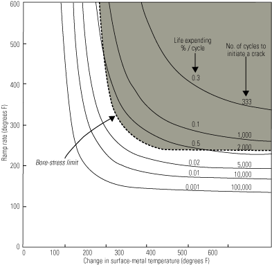

The allowable ramp rates can be found with the help of charts that quantify the turbine life "used up" by each cycle (Figure 1). These "lifetime consumption" charts are calculated for each specific type of HP and IP rotor, taking into consideration the rotor's radial size (the external and internal radii of the rotor body in the most thermally stressed section), the thermophysical and strength properties of the metal it is made of, and the stress concentrators on the heated surface. The ramp rate for varying steam temperatures is derived from the expected transient operating conditions and from the permissible number of cycles that will give birth to a crack, or from the specific lifetime expenditure, measured in percent per cycle. For less frequent transients, the admissible number of cycles is set lower, resulting in greater rates of heating steam temperature changes. The least number of cycles is assumed for cold start-ups; the greatest number is assumed for load changes in the governed range. Figure 1 also shows a shaded zone that is considered "out of bounds" based on the threat of a brittle fracture of the rotor under the combined action of tensile (centrifugal plus thermal) stresses in its depth, near the central bore or rotor axis.
1. Setting the ramp rate limits. Permissible turbine ramp rates can be derived from ranges in rotor surface metal temperature changes and specific low-cycle fatigue limits. Source: General Electric Co.

The maximum thermal stress on a rotor's heated surface is commonly considered to be proportional to a so-called "effective" metal temperature difference across the rotor's radius in its most-stressed section: between the surface temperature and the integral average temperature in the section. The tensile thermal stress in the rotor depth (on the central bore surface or near the rotor axis) is commonly derived from the entire radial temperature difference between the rotor's heated surface and depth. The aforementioned metal temperatures and temperature differences should be the object of on-line temperature monitoring for steam turbine rotors. However, because their direct thermometry is too complicated and unreliable, the problem must be solved indirectly by means of physical or mathematical modeling.
