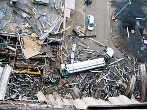

On January 8, 2007, a hydrogen explosion at the Muskingum River Power Plant’s 585-MW coal-fired supercritical Unit 5 caused one fatality, injuries to 10 other people, and significant damage to several buildings. The explosion occurred during a routine delivery of hydrogen when a hydrogen relief device failed, which allowed the contents of the hydrogen tank to escape and be ignited by an unknown source. This article covers the findings of the incident investigation and the actions the plant has taken to prevent a reoccurrence.

1.    A somber scene. A hydrogen delivery truck is surrounded by debris from the explosion at Muskingum River Power Plant’s Unit 5. During delivery, a hydrogen relief device failed, permitting the contents of the hydrogen tank in question to relieve and be ignited by an unknown source. Courtesy: American Electric Power
