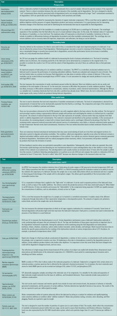

Table 1.	Prioritizing lube oil degradation tests. Source: Analysts Inc.

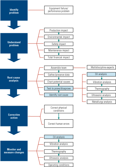

An RCA must begin with an understanding of the problem and a list of all of its possible causes, however remote (Figure 1). Care should be taken not to assign blame for the failure at this point in the investigation. For each potential root cause, experiments and tests should be devised to test its potential existence. Keep in mind that using data to prove a theory false (the devil's advocate approach), is as viable as taking the normal, causative approach—because that data can eliminate incorrect assumptions.
1.	The right path. An example of the root cause analysis methodology at work. Source: Analysts Inc.

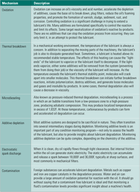

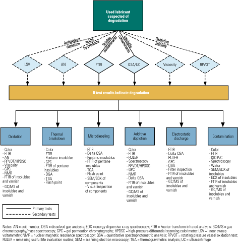

Oil analysis professionals should already be familiar with the priority list of fluid-testing techniques and procedures presented in Table 1. For those less conversant with fluid-testing options, the available tests are categorized as primary, secondary, and "other useful." Cross-check these tests against some of the common fluid degradation mechanisms listed in Table 2 and shown in Figure 2 to help in the selection process. Consult your fluids professional to determine which tests are right for you.
Table 2.	The relationship between oil analyses and degradation
mechanisms. Source: Analysts Inc.
Table 2. The relationship between oil analyses and degradation mechanisms. Source: Analysts Inc.
2.	One step at a time. Selecting the correct analytical tools to assess lubricant degradation is a key step in employing RCA. Source: Analysts Inc.
