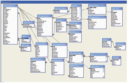

Complex family tree. A well-designed relational database of important data tables is the first step in developing a comprehensive configuration management system. Courtesy: Hurst Technologies

The CM process needs to start in unison with the overall design and design control activities to ensure that functional design requirements are implemented correctly. This is typically a function of a system’s input/output (I/O) list. But the I/O list is just the tip of the iceberg. For each of the true system inputs and final control outputs, an extensive array of settings that number in the tens of thousands must be defined to properly characterize the physical state, the logic, and the performance of each point—both as anticipated and under abnormal conditions. In between the actual inputs and outputs, the verification, manipulation, display, storage, and interfacing of each point must be defined in detail.
The relational complexity of points within a typical DCS is shown in the figure. The key is to have an appropriately defined systems database and tools available to manage the complexity. For example, digital systems should include the ability to be self-documenting, producing many of the functional and physical design documents typically handled manually in the past. Such documents may include system control logics, physical wiring documents, and equipment layout drawings.
