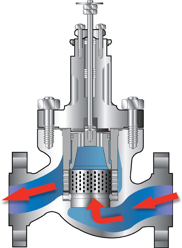

There are very good reasons for power plant designers to specify reciprocating control valves oriented in the flow-to-open direction (flow tending to lift the plug) where compressible fluids are involved. One good reason is that this configuration allows the use of noise-abatement trims, such as drilled-hole cages and tortuous path stacks. Another application advantage is to protect a compressor from surges by allowing the flow to lift the plug and open the valve in the event of stem or actuator failure (Figure 1).
1. Flow-to-open cutaway. Control valves equipped with noise-abatement trim, such as a drilled-hole cage or a tortuous path stack, are typically oriented in the flow-to-open direction. This orientation maximizes noise attenuation by allowing the expanding gases to exit the valve trim and continue downstream without re-converging through the valve’s seat ring, as would happen if the flow direction were reversed. Source: GE Energy
