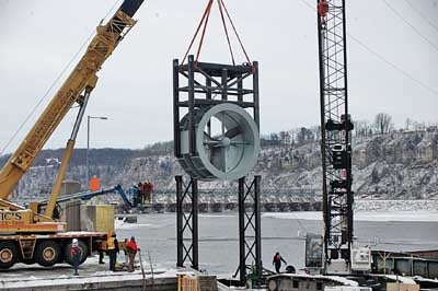

Barely a month after the U.S. Federal Energy Regulatory Commission (FERC) licensed the nation’s first commercial hydrokinetic power station, Houston-based Hydro Green Energy in January completed installation of the first of two turbines at an existing run-of-river hydropower plant on the Mississippi River for the Minnesota city of Hastings. When the second turbine is installed later this spring, the two hydrokinetic turbines will constitute a floating array that will sit on top of a barge at the Army Corps of Engineers’ Lock & Dam No. 2 (Figure 1).
1.    Flotsam and jetsam. Houston-based Hydro Green in January installed the first of two hydrokinetic turbines, each 35 kW, at an existing run-of-river hydropower plant on the Mississippi River for Hastings, Minnesota. When the second turbine is installed later this spring, the grid-connected array will be suspended from a floating barge. Each turbine will drive a generator mounted atop the barge. The array is only the second hydrokinetic project in the U.S. to have garnered federal approval. Courtesy: Hydro Green
