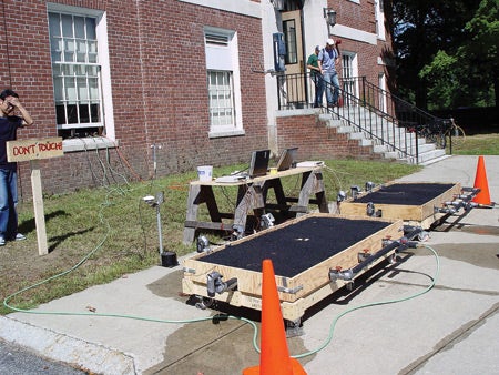

Mallick and his research team studied the energy-generating potential of asphalt using computer models and by conducting small- and large-scale tests. The tests were conducted on slabs of asphalt in which were embedded thermocouples, to measure heat penetration, and copper pipes, to gauge how well that heat could be transferred to flowing water. The team envisions that hot water flowing from an asphalt energy system could be used “as is” for heating buildings or in industrial processes, or it could be passed through a thermoelectric generator to produce electricity (Figure 8).
8. Trail blazing. Worcester Polytechnic Institute researchers are studying the energy-generating potential of asphalt by conducting small- and large-scale tests. The slabs of asphalt contain thermocouples and copper pipes to gauge how well heat can be transferred to flowing water. Courtesy: Worcester Polytechnic Institute
The tests showed that asphalt absorbs a considerable amount of heat and that the highest temperatures are found a few centimeters below its surface. This is where a heat exchanger would be located to extract the maximum amount of energy. Experimenting with various asphalt compositions, they found that the addition of highly conductive aggregates, like quartzite, can significantly increase heat absorption, as can the application of a special paint that reduces reflection. Mallick says the team concluded that the key to successfully turning asphalt into an effective energy generator will be to replace the copper pipes used in their tests with a specially designed, highly efficient heat exchanger that soaks up the maximum amount of heat absorbed by asphalt.
