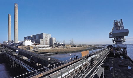

Npower, the British generation subsidiary of German energy giant RWE, is planning to build a 1,600-MW supercritical coal-fired plant to replace an existing 1,000-MW coal power plant in Tilbury, Essex.
The new plant would cost nearly $2 billion and be the first new coal-fired plant built in the country in more than 20 years. In documents filed with the Department of Trade and Industry, npower said it will replace the existing pulverized coal plant (Figure 1) with two 800-MW supercritical units. The new station would be capable of burning biomass as well.
1. Days are numbered. Npower plans to replace this 1,000-MW coal-fired plant in Tilbury, UK, with a new, two-unit, 1,600-MW supercritical coal station. Courtesy: RWE npower
Npower considered retrofitting the Tilbury plant with carbon capture technology but concluded that it makes more sense to build new units that emit considerably less carbon dioxide (CO2) per unit of output. Npower expects the new plant to be in service by 2013. In the meantime, the existing plant will continue operating.
