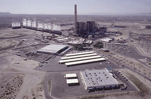

Southern California Edison (SCE, Rosemead, Calif.) closed the 1,580-MW coal-fired Mohave Generating Station in Laughlin, Nev., on December 31. In a filing with the California Public Utilities Commission (CPUC), SCE said it expects the plant to remain off-line for four years—the time it will take for the utility and the plant's other owners to battle environmental groups over the plant's pollutant emissions and to negotiate with two native tribes over rights to the water needed to deliver fuel to Mohave as a slurry. The shutdown concerns many in the Southwest, because Mohave (Figure 1) was a key source of electricity for Arizona, Nevada, and Southern California. The plant and the coal mine that supplied it also provided jobs for the Hopi and Navajo nations, whose unemployment rates exceed 50%.
1.	First air, now water. Owners of the 1,580-MW Mohave coal-fired power plant in Nevada shut it down one day before violating a seven-year-old court order to reduce the plant's air pollution. It may remain off-line for years unless a new source of water for its slurried-coal fuel is found.
Courtesy: Southern California Edison
