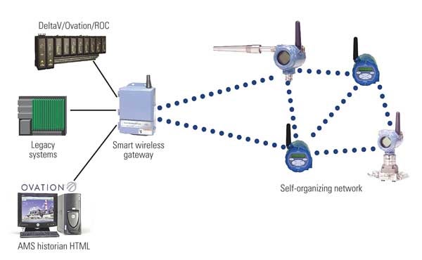

In WirelessHART self-organizing networks, each device needs only to maintain radio line-of-sight to one other device on the network and does not need to have direct line-of-sight to the gateway (Figure 3). Because each device is typically in communication with several of its peers, it will have redundant transmission paths available to it. If an obstruction blocks one transmission path, the blocked device will automatically revert to a redundant link to pass traffic to the next-nearest neighbor. That neighbor then forwards this traffic on to the gateway.
3. Disciplined organization. WirelessHART field networks utilize a self-organizing topology in which each device serves as a router for the traffic of other devices within radio range. This enables a self-organizing network to be far more reliable and fault-tolerant than older point-to-point systems. Source: Emerson Process Management
