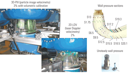

To measure the phenomena of interest in hydroturbines operating at low flow rates, G.D. Ciocan and M. Iliescu delivered—for the first time—experimental data on the velocity field in the zone where the vortex rope develops. The measurements (Figure 1) were performed using a 3D stereoscopic particle image velocimetry (PIV) imaging system from Dantec Dynamics Ltd. (Bristol, UK). The system uses two double-frame Hi-Sense cameras synchronized with a double-pulsed laser as well as a unit for processing the real-time velocity field data.
  1. First measurements. These measurement techniques were used to develop empirical data for validating simulations of hydroturbines' vortex ropes.

The researchers designed a special transparent cone with two large symmetric windows to provide optical access to the cameras and a narrow window for access to the laser. All three windows were given flat external surfaces to minimize optical distortions. Data on the velocity field were obtained under several pressure conditions.
J. Arpe collected experimental pressure-fluctuation data by using a HP-VXI control system to simultaneously acquire signals from 96 pressure transducers mounted on the walls of the elbow draft tube (Figure 2). The signals were sampled at 200 Hz to provide a good dynamic range for the frequency analysis.

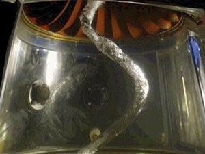

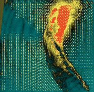

2. Rope dance. The flow structure of a vortex rope captured by particle image velocimetry.

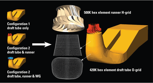

GE Energy engineers limited the domain of the simulation to the runner and draft tube as a tradeoff between accuracy and the size of computing resources needed (Figure 3). The directions of flow and mass flow were specified at the inlet boundary based on a previous, staged-flow analysis of the stay vane, guide vane, and runner assembly. An outlet boundary condition was specified for the outflow. After the engineers developed a steady-state solution for the flow domain, they used it to begin simulation of unsteady operation (Figure 4).
  3. Model behavior. These were the computational flow domain and meshes developed for the simulation.

The difference between the experimental results and numerical predictions was less than 2.5% for mean pressure level—about the same as the accuracy of measurement. Simulations of the mean velocity field also showed good agreement with physical measurements. The phase average vector field showed only a small difference because it was closer to the cone wall in the simulation. The vorticity field (which shows the position of the vortex rope) also was well predicted by the simulation, with a small (5%) difference in the measured and predicted position of the vortex. However, the measured amplitude (intensity) of the vortex was about 18% smaller than the simulated predicted. This larger discrepancy was attributed to the use of a relatively coarse mesh to simulate the geometry of the draft tube, especially in its cone region.
