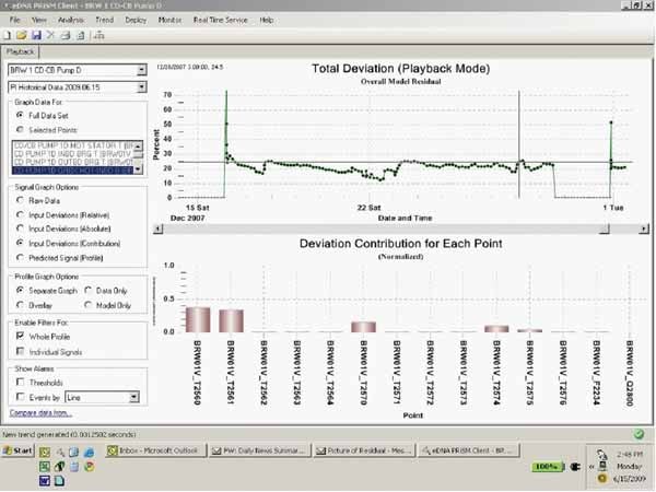

1.     Quantify the failure. The top graph indicates a 25% deviation from normal condensate pump operation as determined by the multidimensional PRiSM model analytics. The second graph indicates that measurement sensor readings BRW01V_T2560 (inboard bearing temperature) and BRW01B_T2561 (outboard bearing temperature) are the main contributors to the deviation. Source: InStep Software
